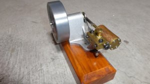

This Finally arrived.
I ordered castings for the myfordboy steam engine some time ago. I think it has a similar cylinder and valve as the traction engine. I do not remember the exact cost, but I thought it was reasonable and making it worked out fine ( if compressed air countsUmm just to knock this on its head, Myfordboy is not a jerk, just protective of his income. I've dealt with him on many occasions and he is a pleasant guy who will help if he can.

Looks like a fine bit of silver soldering, well done.got the boiler all brazed up.
Jasonb you were right the safetysilv 56 with black flux was easier to use.
on the first about half of the boiler i used a large propane torch. but i had a large mapp gas torch that was given to me along with a large bottle of gas about 1/4 full so i used that and a huge difference with mapp gas. ive used oxy accetalene with a jewelers torch before and have to be carefull not to melt parts, propane is just a tadd bit to cold and hard to get it flowing but mapp gas was just right. would recomend that for silver brazing.
Whiteout correction fluid works great at keeping the solder out of the threaded areas and where you dont want it to go.
