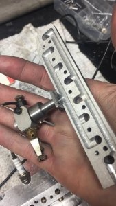

Next up is the distributor, in the plans for the seal engine this has the ignition points built in but I am hoping to have try with some sort of electronic ignition set up in the future so I have built distributor with no provisions for fitting points inside, for now the points will be mounted on the opposite end of the cam shaft. This distributor is probably a fair bit larger than it needs to be but it’s my first one so I wanted to keep it simple for now. If everything works ok there’s no reason why I couldn’t have a go at making a smaller one. I’m not sure how small you could go without the spark jumping across the electrodes inside.

The inlet/ exhaust manifold was next. Again this was a learning curve for me to match up two halves with mirroring cutouts. Thank goodness for the digital read out is all I can say! I might have a go at another manifold with slightly different design once the engine is proven, I’m wondering if I could make the manifold a fair bit slimmer as the ports are only 6mm round then drill the exhaust ports right through both parts of the manifold to the outside and mount a tubular manifold onto that, this might help keep some of the heat out of the manifold.
