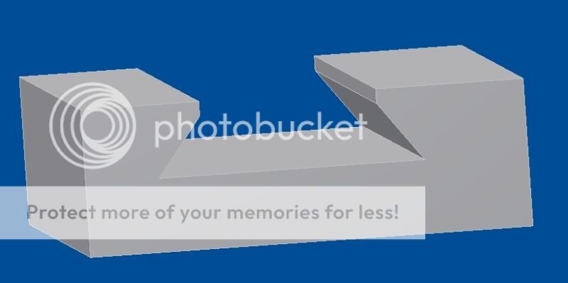

After cutting up the tool holder blank at work into aproximatly 55mm lengths, I brought them home and set about sqauring them up and reducing the width to 70mm to match the tool post.
The first operation was reducing the width of the holder. Reference height was taken from the dovetail edge on the moveable jaw of the vice.
Once one side was done, I flipped it over and did the other side. This ensured that the dovetail was central.
All 11 holders were done before moving on to the next operation.
Next was to square up and clean up the adjacent side. Again all 11 were done on one side before flipping them over and milling the final side to size.
