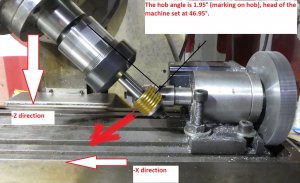

Quite some things that leave room for improvement on my modified milling machine, a mid air flying hob and when the hob angle is changed it affects z-height as well as x position. This makes cutting helical gears a pain to set up, because I even need to move the workpiece spindle to the other end of the milling table. Besides having to figure out workpiece rotation and blank diameter. (pushing me a little out of the comfort zone above elementary school)
