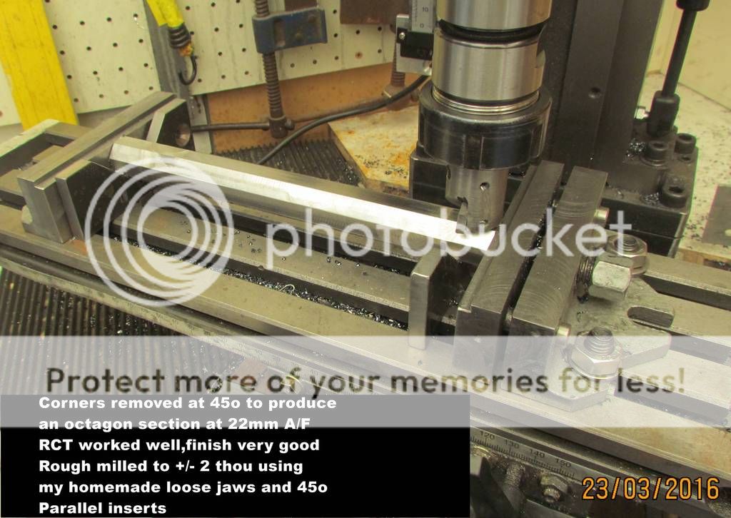

When a house was being built on the block next door I scrounged some pieces of rebar for possible use.I started with a 10" piece of nom 30dia and machined
to the most economical section. 22mm a/f octagonal just as an excersize
It machined well with good finish.I don't know the grade would call it high tensile,a good source of tough steel for pins,nuts and bolts etc.Any input

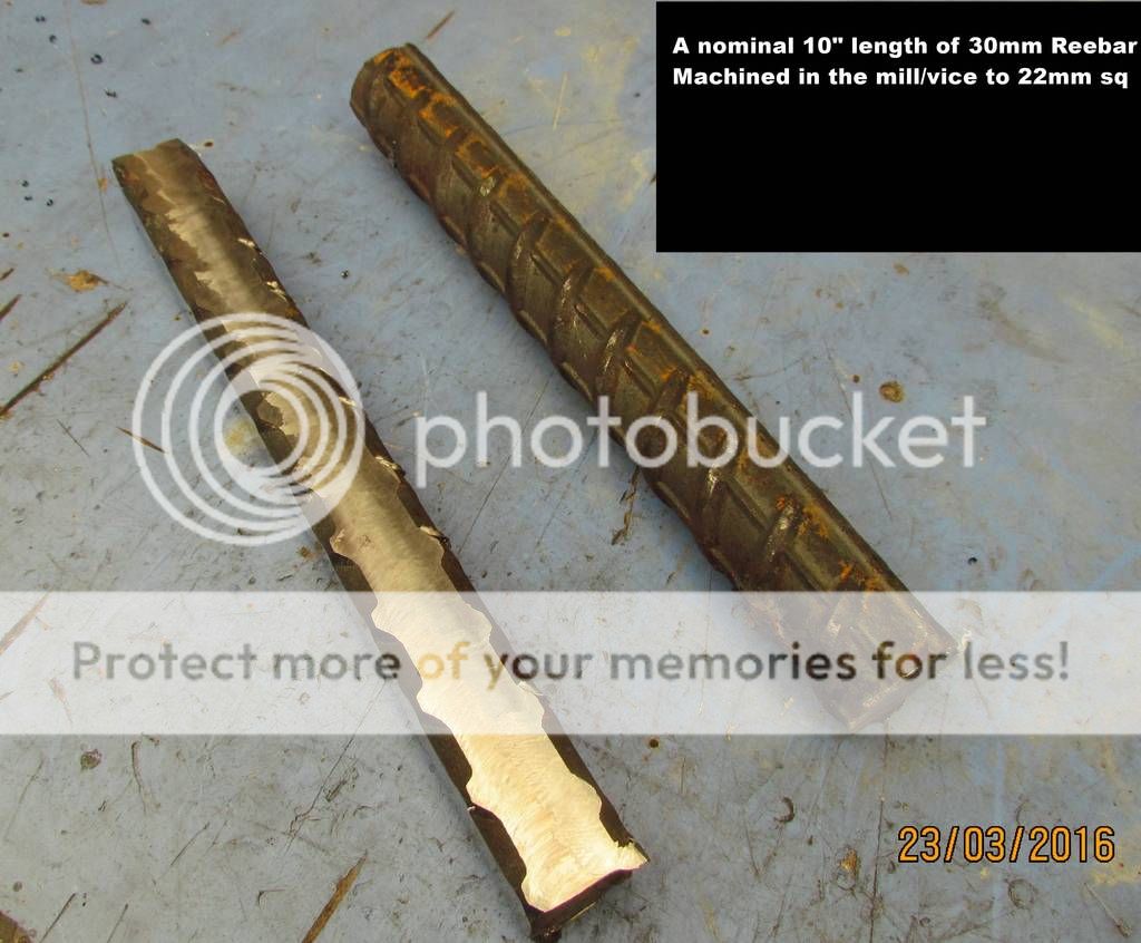

I experimented with turning some rebar a few months ago. The surface finish I got wasn't great, but the price for rebar is cheap. From .5" rebar I got some .4" round once the extrusions were cut down.
Yes machining the surface is labour intensive but I think worth the effort

The first piece I tried however machined well with excerlent finish.From
experience I would say good quality HT steel and its free,just the stuff to keep in reserve for special jobs

I have machined another piece of rebar from nom 30mm to 7/8" a/f hexagon
My thoughts are as follows
The far east rebar is likely to be poor quality but the western world
has better quality control and certification,maybe I am just lucky however
1- My samples in my opinion are high grade high tensile steel
2- The steel machined better than hot rolled mild steel with carbide tooling
3- The finish was excerlent,far superior to hot rolled
4- Running a file over to clean up the burrs proved it was high tensile
as old school engs know it files and sings and the file slips a little
I would highly recommend others to give it a try.I have made sections
not readily available in my neck of the woods and will make a hex nut
next to see how it performs with drilling and tapping using H SS
