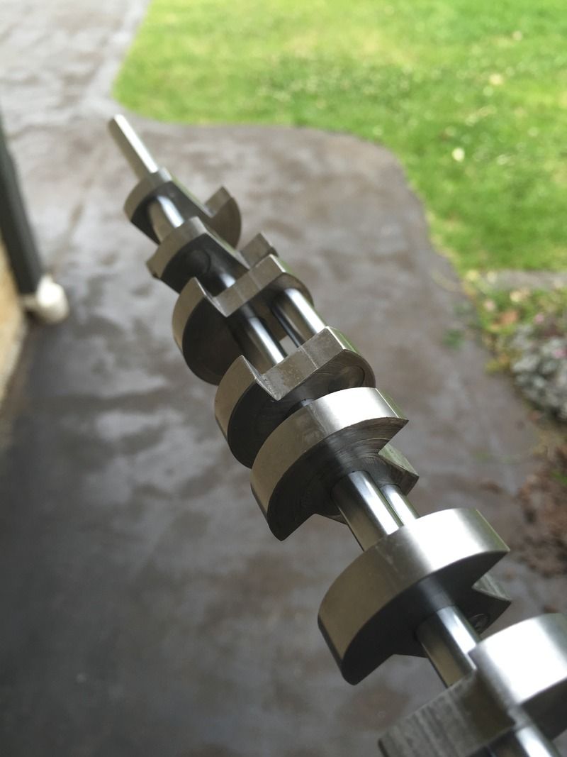

Hi all. I have been working on a new engine and am having trouble getting a strong and true crankshaft - the engine is a horizontally opposed 2 stroke, with two 'clapping hands' pistons per cylinder, which makes it difficult to make a non-wobbly fabricated crank. The bores are 30mm with each piston having a 30mm stroke, so its not a small engine
I am wondering if anyone has had experience of cast iron for building up the crank? I can't cast one, but I have a supply of grey (meehanite) cast bar which I could machine. Is it going to be man enough for the job? Don't want to go to all the trouble of making it only to have it fly to pieces
Thanks for any advice

i just finished a dual opposed engine and I machined the crank from 1144 stress-proof steel. It is very stable and never moved when i machined it. ---Brian
I would not use grey cast iron, better with SG Iron, I have done cast cranks from that but it won't be easy to join if making a built up crank.
I have also done a 25mm bore x 25mm stroke opposed twin and cut from a solid piece of round EN8
Thanks chaps. I suspect that I knew deep down that the CI was not really going to work, I guess it could if it was massive enough but I don't have space in the crankcase for that. Looks like machining it from a solid bar is the best option, fabricating is not really rigid enough and alignment of the pieces is hard to do, the last one I made it took more time and material to make the assembly jig than to make the crank. This is a picture of the trial assembly, this was the point where I realised the crank wasn't straight enough. Ah well.

I'm new to this model engine game, so learning as I go. The crank has four separate throws with webs in between each one, and I solved the alignment problem by making a flat on each of the webs and using that as the reference point for drilling and assembly. The problem I have is more one of straightness than alignment - the crankpins are pressed in, then clamped with a screw and pinned to keep them from coming loose, which seems to work ok, but the shaft is quite 'rubbery' and I can't get it to run true, and because its quite long (around 120mm) even a small runout adds up to significant wonkiness at the ends. Even with this, the engine would probably run ok, but I'm using toothed belts to drive the oil pump and the supercharger and the runout will cause issues there I think.
I'm going to try machining between centres from a solid steel bar and see if that gives it less rubberyness - even if it does end up with some runout, I may be able to straighten it with a press.
